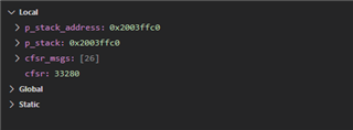

    Even more, I've added the hard fault handlers from the SDK, and here's the log:
    00> <info> app: Succesfully send the search for gate<error> hardfault: HARD FAULT at 0x00008D52
    00>
    00> <error> hardfault:   R0:  0x20040000  R1:  0x00000000  R2:  0x00000000  R3:  0x20015410
    00>
    00> <error> hardfault:   R12: 0x20020BD0  LR:  0x00008D45  PSR: 0x4100000E
    00>
    00> <error> hardfault: Cause: Data bus error (PC value stacked for the exception return points to the instruction that caused the fault).
    00>
    00> <error> hardfault: Bus Fault Address: 0x20040000
    Setting a breakpoint here, I can see the following variables: and  Still chasing a memory corruption, I've enabled more debugging from freeRTOS:

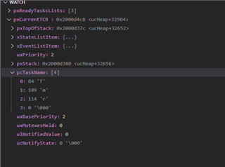

  • OK, I think I got it. I was single stepping through the mqttsn code, when stack overflow handler kicked. Really lucky here!
    Here's what the current TCB was showing:
    So it was the timer task that was running low on stack. The solution, of course, was to increase the task size for the timer task.
    In FreeRTOSConfig.h, I bumped the timer task stack depth to 160:
    #define configTIMER_TASK_STACK_DEPTH  ( 160 )
    And it all went fine from there.
    Thanks for pointing me into the right direction, really appreciate the support!
    Edgar
