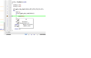

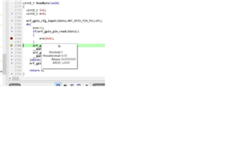

About the bTime1msInterval is solved,I changed it' type from union to staic bool. But this morning,I use a local parameter in a function.When reaching it,I can't be changed correctly by OR 0x01.The code is blow:
Step1:
Step2:
when the PC reach m=m|0x01;,and surmount it,It's value still is 0x00.

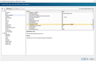

Hello!
Could you try to turn of compilation optimization in Segger and see if that helps? Right click the project, select "options" and choose "Optimization level" none for all project instances. See the picture below:
It could be that "m" is optimized away if it's not used.
Carl Richard
