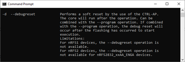

  • But isn't nrfjprog limited to exclusively working with Segger j-link compatible interfaces?
    Also as mentioned "nrfjprog -p --family nrf52" resets the chip deep enough to disable debug interface.
    I would however like to know how "nrfjprog -p --family nrf52" performs the reset, which registers does it write to, does it send a bit stream to the nRF52?
    As a side note writing 1 to CTRL-AP->RESET does reduce the idle current indicating that the debugger circuitry has been disabled, but the nRF52 seem to be stuck in reset/never reboots.
    And I have to power cycle the device to regain control of it.
