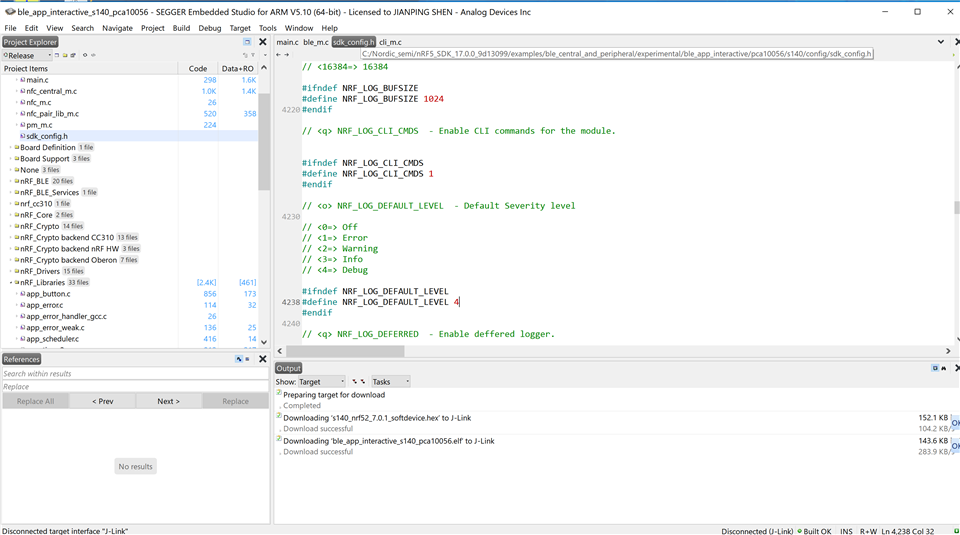

  • Hi Amanda,
    Thank you for looking into it.
    To make things simple,i didn't modify the code at all. The dongle was programmed with the original hex file from the downloaded SDK. I did compile the DK code using SES but without any change at all.
    I installed latest wireshark and the nRFSniffer. unfortunately the sniffer doesn't support the nRF52 dongles i have, and although it supports the DK, but i only have one DK and needed it to run the ble_app_interactive application. I looked at the sniffer software hex files and there was no hex file for PCA10059 which is the dongle i have.
    Modifying the NRF_LOG_DEFAULT_LEVEL from 3 (info) to 4 (debug), didn't change the CLI output, i did rebuilt the project a couple of times to be sure.
