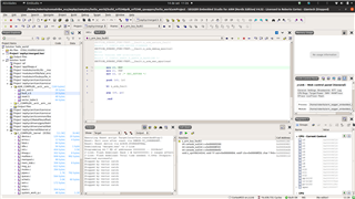

SPU NRF53 not run non secure app
No available samples initiate the non-secure CPU (CONFIG_SPM = y)
the secure cpu is loop!
Zephyr master
NRF master
Help me please!
The test consists of running a simple hello world on cpuns nrf5340pdk.
Thank you.

  • I was able to make SPM work on the nRF53 DK and NCS v1.3.0, I did the following:
    • cd zephyr/samples/hello_world
    • west build -b nrf5340pdk_nrf5340_cpuappns && west flash
    Try running nrfjprog --eraseall first if this doesn't work
    Simon
  • not yet Simon!
