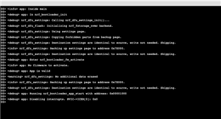

I am using SDK16, and using BLE sample project (central app_ble_blinky)
when I am taking sample project without BLE , I am able to add UART secure bootloader, and I am able to sign all and update application over UART
however, when I try to do them same for BLE based project I am getting the following:
please advice how to resolve this issue
thank you
  • I am not sure how you generated the package that you tried to flash.
    Can you please try to copy the attached test.bat into the path:
    SDK16.0.0\examples\dfu\secure_bootloader\pca10040_uart\armgcc\
    and call it from the command window.
    NB: It will delete the dfu_public_key.c found in examples\dfu\secure_bootloader. If you need this key in the future, please make a backup.
    The script will generate a new dfu_public_key.c. I included it because it needs the matching private.key in that location.
    You also need to modify the last line in the script from COM7 to whatever com port you are using.

    Let me know if it doesn't work. If it works, what differs in this script from what you do when you test?
