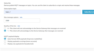

    I tried reproducing this with the AWS IoT MQTT client, but it worked fine here.
    If you are also testing with the AWS IoT MQTT client, and sending packets from the nRF9160 with QoS 1, then make sure that you set QoS to 1 in AWS:
    I used the attached modified mqtt_simple sample to test it, using NCS v1.3.0.
    From the  AWS IoT MQTT client I publish a 2KB packet on topic_2. The nRF9160 is subscribing to topic_2, and when it receives a packet on topic_2, it will publish the same packet to topic_1 10 times. In the AWS IoT MQTT client I'm subscribing to topic_1, and I get the packet 10 times without any issues.
