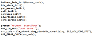

    Thank you for the links to the UART documentation and example.The below is from the UART example code, and it seems to print "UART Start!", but none of the commands surrounding this log statement seem to have anything to do with UART. How is the STARTTX task actually triggered?
    Are you familiar with the NRF logger module? What is happening in those two lines is in fact that the printf statement is sent through UART ( because of the RETARGET definition in the sdk_config.h file ), and the NRF_LOG_INFO message is sent through the RTT debug logger. Please see the answer by my colleague in this ticket regarding retargetting of stdio functions.
