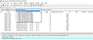

    I try to sniff rf logs by wireshark.
    But i don't understand how to setup filter to catch interesting devices.
    I enter passkey
    But addresses are changing on every connect (they are random)
    I enter passkey
     You need to select the advertising device from this dropdown menu:

    The matter is - when disconnections appears, that is cycling every few seconds.
    So I can't catch address in list of wireshark.
    Could I set address of central device as not private random (for debugging). and use it for filtering in wireshark?

    It is not possible to filter on a central device, unfortunately.
    I assume you want to use the sniffer trace to figure out what's wrong. Please be aware that when the link is encrypted using LESC, the sniffer will not be able to sniff the connection anyway, since sniffer devices can't keep up with LESC, because of it's nature. It could keep up for some time (with undecrypted packages), but eventually it can't keep up with the channel switching, so it will loose the connection.
