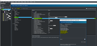

     Yeah, I agree with Jörg Fischer's suggestion. You can have an application that doesn't use the SoftDevice. You only need to change the FLASH and RAM start address and size. You can test and modify nRF5_SDK_17.0\examples\peripheral\blinky\pca10040\mbr with the FLASH and RAM start address and size in nRF5_SDK_17.0\examples\peripheral\blinky\pca10040\s132.
    Right-click on the project -> Common -> Linker -> Section Placement Macros
    -Amanda H.
