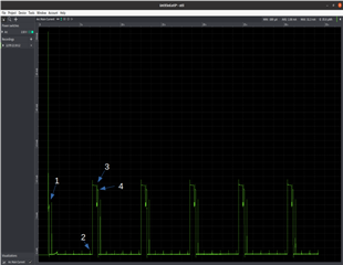

Point1) Otii powers up firmware starts.
Point 2) main calls my I2S function in my i2s module. This function starts the PWM "clock" operation.
Point 3) The function stops the PWM and returns to main.
Point 4) main advertises the acoustic value. Repeat the process.
Unfortunately, this is a screen shot of just PWM in action. When I include the actual operation of I2S the result is shown in the next screen shot.

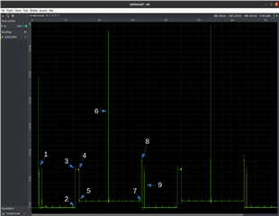

Points 1 and 2 are the same as the first screen shot.
Point 3 is where nrfx_i2s_start is called and Point 3 is where nrfx_i2s_stop is called.
As you can see main never advertises. From debugging it is the nrfx_i2s_stop function that "blows-up" timers across the firmware. Here is a zoom of the Point 3 to Point 4 area.

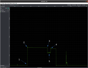

Point 1 main calls the function.
Point 2 The function starts PWM
Point 3 nrfx_i2s_start      Point 4 nrfx_i2s_stop
Point 5 shows the DMA of the I2S buffers.

    Point 1) Otii powers up and firmware starts.
    Point 2) main's timer triggers a call to "i2s_mic_generate_an_spl". main waits for it to return.
    Point 3) "i2s_mic_generate_an_spl" starts the PWM "clocks". It starts a 500 mS app_timer to give the microphone a half second to stabilize.
    Point 4) nrfx_i2s_start is called. "i2s_mic_generate_an_spl" waits until the I2S data handler has toggled a flag signalling that data collection is complete. On this first call, "i2s_mic_generate_an_spl" then stops the PWM "clocks" but does not call nrfx_i2s_stop. "i2s_mic_generate_an_spl" returns to main.
    Point 5) Back in main. Note the elevated power level. Don't know what causes that. There must be a clock associated with the nrfx_i2s_start call still running.
    Point 6) main makes it's timer induced advertisement.
    Point 7) main's timer triggers the second call to "i2s_mic_generate_an_spl" and waits for it to return.
    Point 8) In this second call, the first thing "i2s_mic_generate_an_spl" does is call nrfx_i2s_stop. It would then start the PWM "clocks", wait on it's timer, call nrfx_i2s_start, wait for the I2S data handler to toggle the flag etc.. Obviously, there is no PWM, no I2S, etc...
    Point 9) Firm ware reset and repeat of sequence.
    I'm doing something that isn't allowed. I just can't figure out what it is. I'm hoping its something obvious to more experienced folk and greatly appreciate their observations and thoughts.
  • After I call nrfx_i2s_stop, an assertion is thrown in the I2S data handler. For some reason the data handler seems to be called by the I2S peripheral even after nrfx_i2s_stop is called. The assertion is NRF_ERROR 8 - Invalid State on a nrfx_i2s_next_buffers_set call. The invalid state is defined as either the buffers have already been supplied or the peripheral is currently being stopped. The way I fixed this was to wrap the code in the i2s_data_handler in an if (status & NRFX_t2S_STATUS_NEXT_BUFFERS_NEEDED) condition.
    My understanding is that the data handler's 2nd in parameter, status, will be either 0 or NRFX_I2S_STATUS_NEXT_BUFFERS_NEEDED. Although I have read about a second value called NRFX_I2S_STATUS_TRANSFER_STOPPED in Drivers->nrfx v2.3. That value isn't available in my environment.
    So it works now and my problem had nothing to do with clocks or the softdevice. However, I have yet to figure out how the code worked in a none BLE application. Back to work.
