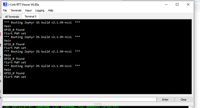

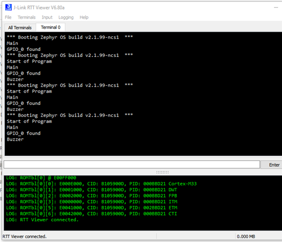

    The Timer works fine without the update of the PWM .
    When the PWM is re commented , the program reset itself ( see pic ).
    The same code works fine in another small project .
    Please Advise

    It is the pwm_pin_set_usec(pwm_dev,PWM_IO, 400, 200,0) that make the reset .
  • You should not call functions that take long time or rely on other interrupts from a k_timer handler, as its also in interrupt context.
    If you use a work queue, you schedule the function to another context to avoid this scenario, just as described in the work queues documentation:
    https://docs.zephyrproject.org/1.9.0/kernel/threads/workqueues.html
    Håkon

  • Hi.
    I stripped all unnecessary code .
    Still the same error ( reset over and over.)
    Please Advise
