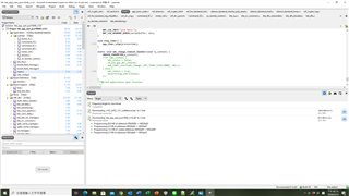

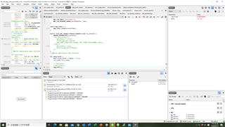

Hi Nordic,
Why I cannot directly use segger's "Build and Debug" to download file to nrf52832, after I modify some code?

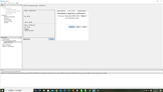

After I use nrfGo Studio first to program the hex file into nrf52832.
Then I can use Segger to "Build and Debug".
But next time I modify my code and do "Build and Debug", there's still the same problem(download failed).
Is my code size too big? or flash not setting right? or jlink dll version not pair the SDK16.0.0?
    Perhaps nRFgo studio is using the COM port, so that SES can't program the device?

  • I am using nRF52832 DK and our product using nrf52832 chip. Both board have the same problem. First I test ble_app_uart_pca10040_s132(peripheral), there is no problem. To add few code, there is no problem. But when I add more code, the problem happened. Once the problem happened, it happens every time I re-compile the project.
    After erasing the chip, it have trouble to download s132_nrf52_7.0.1_softdevice.hex.
    I have the same problem when I develop ble_app_uart_c_pca10040_s132(central).

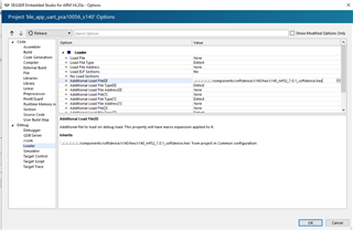

     Have you checked that the path to the softdevice in the SES project is correct?
    Have you moved the project file's location, or is it in the same location as when you unzipped the SDK?
