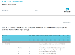

Hi, I want to distinguish whether the USB is connected to a PC or a power adapter.
For my application, FATFS still needs to work when connected to a power adapter, so it can not be distinguished via the USB event, as described in https://devzone.nordicsemi.com/f/nordic-q-a/36414/usb.
My idea is that distinguish by the voltage level of D+ and D- when USB is connected. I found a USB register DPDMVALUE  relate to the D+ and D-, but I always get a zero value whether connecting to a PC or a power adapter.
My question is how to get the value of DPDMVALUE ? Does it need any other setting? Thanks!

    maybe I didn't understand your case right, but I think you can still use USB SOF event - for wall adapter, there will be only APP_USBD_EVT_POWER_DETECTED.
    DPDMVALUE can only force D+ and D- to some state, it cannot be used to detect their states.
