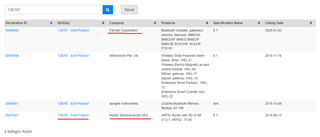

4) Whether the same QDID can be used across products. I am bit confused with below snapshot. If I see D048051, I am seeing same QDID and “Combined Designs” same as Nordic. So in this case even they are using the same.

    I have last query on your statement "So if you are using the same module and firmware in different products, that is fine" in query 4.
    In snapshot both are from different companies. In that case either module or firmware will be different. But still how come there is same QDID.

  • The QDID refers to a specific qualified BT softdevice stack used in the product, here is the current list for QDID for the nRF52840:
    https://infocenter.nordicsemi.com/topic/comp_matrix_nrf52840/COMP/nrf52840/nrf52840_ble_qdid_qual_matrix.html
    Several products may use the same BT stack (thereby refer to the same QDID).
