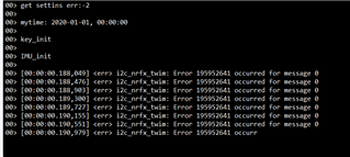

  • If so, can I turn off Console and Logging and use I2C_0 as 9160 to communicate with peripherals?Now I have tried this and can also obtain binding, but in fact I2C cannot communicate, there is no corresponding message display peripheral, and it seems that the SCL and SDA pin of I2C are occupied by other functions.
    I used an oscilloscope to capture the waveform and found that the waveform could be normally seen using I2C_2, but the waveform could not be seen after using I2C_0. It seemed that the SCL was forcibly restricted to a high level by an application.
    Could you share your latest prj.conf file?
    Also I would advice you to port your project to NCS 1.4.0 and do a re-test.
    I suspect that you are running on NCS1.2.0 and there was an issue with similar symptoms as you see in that version.

  • You have to manually disable the UART_0 in the prj.conf, if not the project will use the default board settings.
    But please try this on the latest NCS as well.
