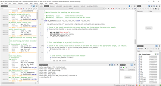

Notifying the Custom Value Characteristic Issue
I am following the below link for creating custom services/characteristics.
https://github.com/bjornspockeli/nRF52-Bluetooth-Course
1-I have added the notify part but my characteristics not showing notifying properties. I am attaching the files. Kindly any solution?

ble_cus.h
/* This code belongs in ble_cus.c*/
#include "sdk_common.h"
#include "ble_srv_common.h"
#include "ble_cus.h"
#include <string.h>
#include "nrf_gpio.h"
#include "boards.h"
#include "nrf_log.h"
/**@brief Function for initializing the Custom Service.
 * @param[out]  p_cus       Custom Service structure. This structure will have to be supplied by
 *                          the application. It will be initialized by this function, and will later
 *                          be used to identify this particular service instance.
 * @param[in]   p_cus_init  Information needed to initialize the service.
 * @return      NRF_SUCCESS on successful initialization of service, otherwise an error code.
uint32_t ble_cus_init(ble_cus_t * p_cus, const ble_cus_init_t * p_cus_init);
uint32_t custom_value_char_add(ble_cus_t * p_cus, const ble_cus_init_t * p_cus_init);
void ble_cus_on_ble_evt( ble_evt_t const * p_ble_evt, void * p_context);
    if (p_cus == NULL || p_cus_init == NULL)
        return NRF_ERROR_NULL;
    uint32_t   err_code;
    ble_uuid_t ble_uuid;
    // Initialize service structure
    p_cus->conn_handle               = BLE_CONN_HANDLE_INVALID;
    // Add Custom Service UUID
    ble_uuid128_t base_uuid = {CUSTOM_SERVICE_UUID_BASE};
    err_code =  sd_ble_uuid_vs_add(&base_uuid, &p_cus->uuid_type);
    VERIFY_SUCCESS(err_code);
    ble_uuid.type = p_cus->uuid_type;
    ble_uuid.uuid = CUSTOM_SERVICE_UUID;
    // Add the Custom Service
    err_code = sd_ble_gatts_service_add(BLE_GATTS_SRVC_TYPE_PRIMARY, &ble_uuid, &p_cus->service_handle);
    if (err_code != NRF_SUCCESS)
        return err_code;
    p_cus->evt_handler = p_cus_init->evt_handler;
    // Add Custom Value characteristic
    return custom_value_char_add(p_cus, p_cus_init);
/**@brief Function for adding the Custom Value characteristic.
 * @param[in]   p_cus        Custom Service structure.
 * @return      NRF_SUCCESS on success, otherwise an error code.
    uint32_t            err_code;
    ble_gatts_char_md_t char_md;
    ble_gatts_attr_md_t cccd_md;
    ble_gatts_attr_t    attr_char_value;
    ble_gatts_attr_md_t attr_md;
    memset(&char_md, 0, sizeof(char_md));
    char_md.char_props.read   = 1;
    char_md.char_props.write  = 1;
    char_md.char_props.notify = 0;
    char_md.p_char_user_desc  = NULL;
    char_md.p_char_pf         = NULL;
    char_md.p_user_desc_md    = NULL;
    char_md.p_cccd_md         = NULL;
    char_md.p_sccd_md         = NULL;
memset(&attr_md, 0, sizeof(attr_md));
    attr_md.read_perm  = p_cus_init->custom_value_char_attr_md.read_perm;
    attr_md.write_perm = p_cus_init->custom_value_char_attr_md.write_perm;
    attr_md.vloc       = BLE_GATTS_VLOC_STACK;
    attr_md.rd_auth    = 0;
    attr_md.wr_auth    = 0;
    attr_md.vlen       = 0;
 /* This code belongs in custom_value_char_add() in ble_cus.c*/
    ble_uuid.uuid = CUSTOM_VALUE_CHAR_UUID;
    memset(&attr_char_value, 0, sizeof(attr_char_value));
    attr_char_value.p_uuid    = &ble_uuid;
    attr_char_value.p_attr_md = &attr_md;
    attr_char_value.init_len  = sizeof(uint8_t);
    attr_char_value.init_offs = 0;
    attr_char_value.max_len   = sizeof(uint8_t);
err_code = sd_ble_gatts_characteristic_add(p_cus->service_handle, &char_md,
                                               &attr_char_value,
                                               &p_cus->custom_value_handles);
        return err_code;
    return NRF_SUCCESS;
        memset(&cccd_md, 0, sizeof(cccd_md));
    //  Read  operation on Cccd should be possible without authentication.
    BLE_GAP_CONN_SEC_MODE_SET_OPEN(&cccd_md.read_perm);
    BLE_GAP_CONN_SEC_MODE_SET_OPEN(&cccd_md.write_perm);
    cccd_md.vloc       = BLE_GATTS_VLOC_STACK;
    char_md.char_props.notify = 1;
    char_md.p_cccd_md         = &cccd_md;
/**@brief Function for handling the Connect event.
 * @param[in]   p_ble_evt   Event received from the BLE stack.
void on_connect(ble_cus_t * p_cus, ble_evt_t const * p_ble_evt)
    p_cus->conn_handle = p_ble_evt->evt.gap_evt.conn_handle;
    ble_cus_evt_t evt;
    evt.evt_type = BLE_CUS_EVT_CONNECTED;
    p_cus->evt_handler(p_cus, &evt);
/**@brief Function for handling the Disconnect event.
void on_disconnect(ble_cus_t * p_cus, ble_evt_t const * p_ble_evt)
    UNUSED_PARAMETER(p_ble_evt);
/**@brief Function for handling the Write event.
void on_write(ble_cus_t * p_cus, ble_evt_t const * p_ble_evt)
    ble_gatts_evt_write_t * p_evt_write = &p_ble_evt->evt.gatts_evt.params.write;
    // Check if the handle passed with the event matches the Custom Value Characteristic handle.
    if (p_evt_write->handle == p_cus->custom_value_handles.value_handle)
        NRF_LOG_INFO("Data Write");
        nrf_gpio_pin_toggle(LED_4);
    /* This code belongs in on_write() in ble_cus.c*/
    // Check if the Custom value CCCD is written to and that the value is the appropriate length, i.e 2 bytes.
    if ((p_evt_write->handle == p_cus->custom_value_handles.cccd_handle)
        && (p_evt_write->len == 2)
        // CCCD written, call application event handler
        if (p_cus->evt_handler != NULL)
            ble_cus_evt_t evt;
            if (ble_srv_is_notification_enabled(p_evt_write->data))
                evt.evt_type = BLE_CUS_EVT_NOTIFICATION_ENABLED;
            else
                evt.evt_type = BLE_CUS_EVT_NOTIFICATION_DISABLED;
            // Call the application event handler.
    ble_cus_t * p_cus = (ble_cus_t *) p_context;
    if (p_cus == NULL || p_ble_evt == NULL)
        return;
        case BLE_GAP_EVT_CONNECTED:
            on_connect(p_cus, p_ble_evt);
            on_disconnect(p_cus, p_ble_evt);
       case BLE_GATTS_EVT_WRITE:
           on_write(p_cus, p_ble_evt);
        default:
            // No implementation needed.
uint32_t ble_cus_custom_value_update(ble_cus_t * p_cus, uint8_t custom_value)
    NRF_LOG_INFO("In ble_cus_custom_value_update. \r\n");
    if (p_cus == NULL)
    ble_gatts_value_t gatts_value;
    // Initialize value struct.
    memset(&gatts_value, 0, sizeof(gatts_value));
    gatts_value.len     = sizeof(uint8_t);
    gatts_value.offset  = 0;
    gatts_value.p_value = &custom_value;
    // Update database.
    err_code = sd_ble_gatts_value_set(p_cus->conn_handle,
                                      p_cus->custom_value_handles.value_handle,
                                      &gatts_value);
        return err_code;
    // Send value if connected and notifying.
    if ((p_cus->conn_handle != BLE_CONN_HANDLE_INVALID))
        ble_gatts_hvx_params_t hvx_params;
        memset(&hvx_params, 0, sizeof(hvx_params));
        hvx_params.handle = p_cus->custom_value_handles.value_handle;
        hvx_params.type   = BLE_GATT_HVX_NOTIFICATION;
        hvx_params.offset = gatts_value.offset;
        hvx_params.p_len  = &gatts_value.len;
        hvx_params.p_data = gatts_value.p_value;
        err_code = sd_ble_gatts_hvx(p_cus->conn_handle, &hvx_params);
    else
        err_code = NRF_ERROR_INVALID_STATE;
    return err_code;
2-I also want to show data I have received on characteristics but unable to see.
NRF_LOG_INFO(p_evt_write->data);
Thanks!
