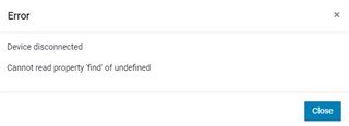

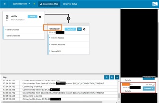

The weird thing is, it advertises fine (I can see the advertising ID), but then when I click "Connect", it popped up as "<Unknown>".
And then shortly I got the read property error.
Please see attached screenshots below.
I also attached the log (and removed some identifying info) below.
And then when I "forced" it, ignoring the error and press "Start DFU", I got: read property "InstanceID" error.

2020-09-18T01:10:23.384Z DEBUG      110 ->  [N/A] type:                 ACK reliable: no seq#:0 ack#:2 payload_length:0 data_integrity:0 err_code:0x0
2020-09-18T01:10:23.384Z DEBUG      111 ->  [00 94 00 00 01 00 00 ] type:     VENDOR_SPECIFIC reliable:yes seq#:4 ack#:2 payload_length:7 data_integrity:1 header_checksum:ae err_code:0x0
2020-09-18T01:10:23.417Z DEBUG   108/ 0 <-  [N/A] type:                 ACK reliable: no seq#:0 ack#:5 payload_length:0 data_integrity:0 err_code:0x0
2020-09-18T01:10:23.417Z DEBUG   109/ 0 <-  [01 94 00 00 00 00 ] type:     VENDOR_SPECIFIC reliable:yes seq#:2 ack#:5 payload_length:6 data_integrity:1 header_checksum:a8 err_code:0x0
2020-09-18T01:10:23.417Z DEBUG      112 ->  [N/A] type:                 ACK reliable: no seq#:0 ack#:3 payload_length:0 data_integrity:0 err_code:0x0
2020-09-18T01:10:23.450Z DEBUG   110/ 0 <-  [02 30 00 00 00 00 00 00 00 03 00 00 18 01 01 00 09 00 01 18 01 0a 00 0a 00 59 fe 01 0b 00 ff ff ] type:     VENDOR_SPECIFIC reliable:yes seq#:3 ack#:5 payload_length:20 data_integrity:1 header_checksum:5 err_code:0x0
2020-09-18T01:10:23.450Z DEBUG      113 ->  [N/A] type:                 ACK reliable: no seq#:0 ack#:4 payload_length:0 data_integrity:0 err_code:0x0
2020-09-18T01:10:23.451Z DEBUG GATTC_EVT_PRIM_SRVC_DISC_RSP time:2020-09-18T01:10:23.451Z connHandle:0 gattStatus:0 gattStatusName:success errorHandle:0 count:3 services:[[uuid:[uuid:6144 type:1 typeString:bleUuidTypeBle],handleRange:[startHandle:1 endHandle:9]],[uuid:[uuid:6145 type:1 typeString:bleUuidTypeBle],handleRange:[startHandle:10 endHandle:10]],[uuid:[uuid:65113 type:1 typeString:bleUuidTypeBle],handleRange:[startHandle:11 endHandle:65535]]]
2020-09-18T01:10:23.481Z DEBUG      114 ->  [00 96 00 00 01 01 00 09 00 ] type:     VENDOR_SPECIFIC reliable:yes seq#:5 ack#:4 payload_length:9 data_integrity:1 header_checksum:7d err_code:0x0
2020-09-18T01:10:23.504Z DEBUG   111/ 0 <-  [N/A] type:                 ACK reliable: no seq#:0 ack#:6 payload_length:0 data_integrity:0 err_code:0x0
2020-09-18T01:10:23.504Z DEBUG   112/ 0 <-  [01 96 00 00 00 00 ] type:     VENDOR_SPECIFIC reliable:yes seq#:4 ack#:6 payload_length:6 data_integrity:1 header_checksum:9e err_code:0x0
2020-09-18T01:10:23.504Z DEBUG      115 ->  [N/A] type:                 ACK reliable: no seq#:0 ack#:5 payload_length:0 data_integrity:0 err_code:0x0
2020-09-18T01:10:27.734Z DEBUG   113/ 0 <-  [02 11 00 00 00 08 ] type:     VENDOR_SPECIFIC reliable:yes seq#:5 ack#:6 payload_length:6 data_integrity:1 header_checksum:9d err_code:0x0
2020-09-18T01:10:27.734Z DEBUG      116 ->  [N/A] type:                 ACK reliable: no seq#:0 ack#:6 payload_length:0 data_integrity:0 err_code:0x0
2020-09-18T01:10:27.734Z DEBUG GAP_EVT_DISCONNECTED time:2020-09-18T01:10:27.735Z connHandle:0 reason:8 reasonName:connectionTimeout
2020-09-18T01:10:27.739Z INFO Disconnected from device E3:5A:9B:xxx, reason: BLE_HCI_CONNECTION_TIMEOUT
2020-09-18T01:10:33.478Z INFO Disconnected from device E3:5A:9B:xxx

2020-09-18T01:10:38.032Z ERROR DFU failed with error: Cannot read property 'instanceId' of undefined.
  • Hi Harry,
     Please provide the nrf_log output from the bootloader when this issue occurs.
    -Amanda H.

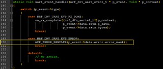

    00> <debug> app: Error 12: ..\..\bootloader\serial_dfu\nrf_dfu_serial_uart.c:150
    00>
    The error:
    I assume the error indicates that it happened at line 150 in nrf_dfu_serial_uart.c. Please see the code snippet below:
