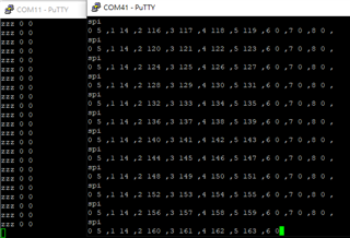

I tried using nrf52832(as slave) communicate with stm32, it successed .

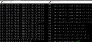

But when I changed nrf52832 to nrf52840 to do the same thing, it failed .
I use the nRF5_SDK_15.0.0_a53641a ,I confirm that the pins have changed
And use nRF5_SDK_15.0.0_a53641a\examples\peripheral\radio\transmitter\pca10040 for nrf52832, ....\pac10056 for nrf52840, and use the arm5_no_packs's keil project
Where I need to modify it?
Can I just change using pca10040 to using pac100056 folder when I change the board?
this picture is stm32(right) send data to nrf52832(left), you can see that it successed
this picture is stm32(right) send data to nrf52840(left),and it failed
you can see that nrf52840 had go into spi IRQ, but it didn't receive anything from stm32.
