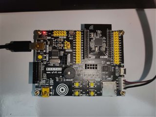

I may have found the reason, that is, there is a certain difference between my development board and the official development board. My board has a Jlink port for programming (buttom right of the board) and a seperate mini-usb port for serial output. (top left of the board). Similar things happened when I tried to run RIOT OS on my board. The Jlink port was recognized as ttyACM0 on Ubuntu and mini-usb port was recognized as ttyUSB0. In the RIOT tutorial, the Jlink port is used for both programming and serial output. But my board use Jlink only for programming and mini-usb for serial output.
Latter, I find that if I plug in & plug out the Jlink after the cold start, the board can respond to the Echo command. The output and the COM port on Windows are shown as below:

    What port (on the PC) you get UART communication over is not something that the nRF can control. From what you describe, it sounds like both the J-Link programmer and the mini-usb with USB-to-serial are connected to the same UART pins of the nRF, and which one of those to use is controlled by logic on the board itself.
    If I understand correctly, there is a J-Link programmer on your board? Maybe it also controls (overrides) the USB-to-serial converter with the mini-USB port, and whether it is connected to the nRF UART pins? You need to consult the documentation for the board, in order to see how things are connected...
    Terje

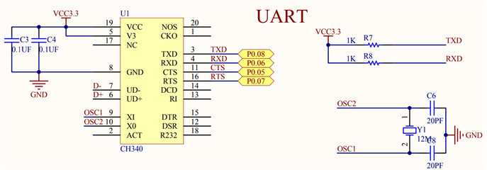

  • Hi Terje:
    Thanks again for the reply. I have find the PCB design of my board. The UART part is shown as below:

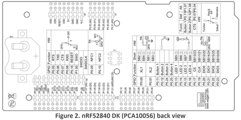

    I checked the PCB of nrf52840 DK, it seems that the UART pin definations are all reversed (e.g. P0.05 is used for RTS on nrf52840 DK but CTS on my board)? Also there is a switch on the nrf52840 DK which can switch between "IF OFF" and "IF MCU". So what is the function of the switch? Is it possible that this is the reason why serial has a timeout problem after a cold start?
    Best Regards
    Yeming Li
    Sorry for the late reply.
    "IF OFF" / "IF MCU" is whether or not the interface MCU on the nRF52840 DK should use the UART connection to the nRF. It is an internal signal line on the DK board. From what I can tell from the hardware files, the interface MCU will use the UART lines if SW6 is set to "DEFAULT" and USB is detected on the interface MCU USB connector. I do not see how it should affect your setup. In any case, what you see is on the third party board, not on the nRF52840 DK, right?
    If you have any activity on the nRF UART pins, when the application is downloaded, then I guess it would be possible to end up in a bad state, that a reset would mitigate.
    Terje
