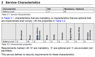

Hi ,
Just one question.
I am trying to create services using hrs examples and its useful.
Currently one question I have that ,
the battery indicator is only notifiable but instead could that service can be made writable as well.

According to the Battery Service specification, which you can find here (click on the 1.0-link next to "Battery Service"), the battery level characteristic can not be written to:
So while it probably is possible to implement it, you will not be able to certify the product with Bluetooth if that is possible.

Ok,
So, Is there any service I can make it as Writable in heart rate example just to quickly check for one experiment.
or I need to create one service to make it writable. ?
You can try to make the battery service writable, just for testing.
It would be adding something like:
add_char_params.char_props.write = 1;
after
add_char_params.char_props.read = 1;
And then you would have to implement something to handle the write events in the on_write() function in ble_bas.c.
However, the heart rate characteristic is only one byte by default, so you would have to change that if you want to send more data:
add_char_params.max_len = sizeof(uint8_t);
add_char_params.init_len = sizeof(uint8_t);
To be honest, it may be easier for you to add the nus service from the ble_app_uart example. Look at how it is implemented in that example. Using that service, you are free to send more data, and you can send this custom data both ways.
