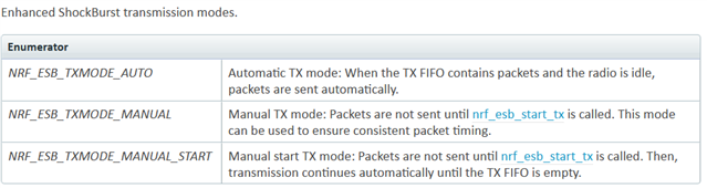

    7.What is difference btween these tx_mode settings:NRF_ESB_TXMODE_AUTO ,NRF_ESB_TXMODE_MANUAL and NRF_ESB_TXMODE_MANUAL_START?
    NRF_ESB_TX_MODE_MANUAL and NRF_ESB_TXMODE_MANUAL_START can be used when there are strict timing sync rules, since you can choose when you want the TX transmission to start. NRF_ESB_TXMODE_AUTO will sent the packets automatically as they are sent to the TX buffer after nrf_esb_write_payload().
