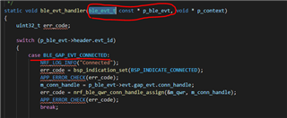

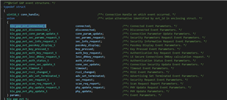

The Peer address can be stored after a BLE_GAP_EVT_CONNECTED has been generated. You can find the peer address in the ble_evt_t event structure. Note that most SoftDevice functions do not use the peer address to refer to the peer but rather the connection handle. The connection handle is assigned to the link of the peer during a connection event.

What exactly do you need the peer address for? Is there a specific function call where this is necessary to pass as a parameter? The peer manager is used bonding, pairing etc and is not necessary to use for storing the peer address. As I wrote in my previous reply:
Jared said:The Peer address can be stored after a BLE_GAP_EVT_CONNECTED has been generated. You can find the peer address in the ble_evt_t event structure. Note that most SoftDevice functions do not use the peer address to refer to the peer but rather the connection handle. The connection handle is assigned to the link of the peer during a connection event.
