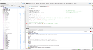

I am working on ble_app_template.
I am trying to save a value in the flash memory of nRF52840.
I am using the following 2 functions to write/read in flash memory but getting this error.
SOFTDEVICE: INVALID MEMORY ACCESS
I am using this memory as a starting memory to save values.(As mentioned in this link:  Flash - Non-volatile memory)
uint32_t f_addr = 0x4001E001;
Any solution for this error?
Thanks
// Create a pointer to that address
uint32_t * p_addr = &f_addr;
uint32_t val = 123456;
void write_T()
    nrf_nvmc_write_word(f_addr, val);
void read_T()
     NRF_LOG_INFO("The Data read from flash is: %d", *(p_addr));
