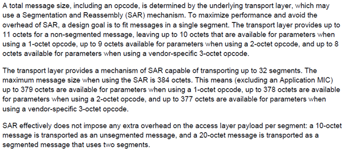

My team was looking to transfer a 20-byte value (or 'message') between a mesh client and server, what is the best way to achieve this? I have practiced with the light_switch and dimming demos for Mesh, but we are not sure how to expand to a larger state size
How do you recommend to transfer this 20-byte message from the client to server?

    Lower Transport Layer: (loc)
    The lower transport layer takes PDUs from the upper transport layer and sends them to the lower transport layer on a peer device. Where required, it performs segmentation and reassembly of PDUs. For longer packets, which will not fit into a single Transport PDU, the lower transport layer will perform segmentation, splitting the PDU into multiple Transport PDUs. The receiving lower transport layer on the other device, will reassemble the segments into a single upper transport layer PDU and pass this up the stack.
    thanks!
