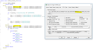

I had some issues with Errata so I tried to build a simple BLE app like Blinky.
The errata functions all compile as return false. For example, nrf52_errata_108
What is going on?

Yes, I am talking about system_nrf52.c in the MDK. When it calls nrf52_errata_108(), that function always returns false
Hi William,
Are you using ble_app_blinky_pca10040_s132.uvprojx for nRF52832?
Could you try to find out why returns false?
You can check the NRF52832_XXAA is defined in the target option. It should work as expected if you don't modify the example.
-Amanda H.
Thanks. KEIL had some issue that made it look like the code wasn't generating. I worked around it.
I was trying to find a clear example to help a client modify their SDK 11 code to work with the current MDK. So you confirmed that too.
