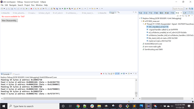

  • Hi Edvan,
    I am using armgcc compiler itself, I'm trying to advertise ble..
    But from  err_code = sd_softdevice_enable(p_clock_lf_cfg, softdevice_fault_handler); called form ble_stack_init();
    it is going to SVC_Handler and crashing.
    I am able to flash the blinky example with the below memories so i'm using the same for advertising ble.

  • So what does sd_softdevice_enable() return?
    err_code = sd_softdevice_enable(...);
    err_code = ?
    What sort of HW are you running this on? You say that it is an nRF51 module. Does this module have an external LFXTAL?
    Edvin said:
    Does the LEDs blink if you test the pca10028\blank\armgcc makefile? This file doesn't require a softdevice.
     Did you test this? Did it compile? Does it blink anything? I don't know if your module has any LEDs. Have you tried to compile without eclipse, using the terminal command "make"?
    We do not support Eclipse. It may very well be that you will  be able to set it up, but there are a lot of things that has to be set up correctly in order for it to work, so I would suggest that you test something that we know works before you enter this.
    At this point, we don't know whether the application you are testing works with the module you are using, and we don't know if your eclipse setup is working.
    This is why I want you to test an example using the armgcc makefile directly, flash it using nrfjprog, and check that it is working. Once you know the example is working, then you can try to open it in Eclipse, and see if you have the same behavior.
