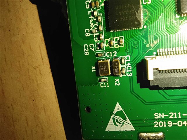

    What sort of HW are you running this on? You say that it is an nRF51 module. Does this module have an external LFXTAL?
