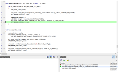

Inside the saadc_callback function, I process the data and call the ble_nus_data_send function, as seen bellow:
        ret_code_t err_code;
        err_code = nrf_drv_saadc_buffer_convert(p_event->data.done.p_buffer, SAMPLES_IN_BUFFER);
        saadc2ble_convert();
        uint16_t length = (uint16_t)UART_TX_BUF_SIZE;
        err_code = ble_nus_data_send(&m_nus, adc_output, &length, m_conn_handle);
the saadc2ble_convert function simply converts the data from uint16_t to uint8_t and the length of the data transmitted via ble_nus_data_send function has not been modified from the initial example:

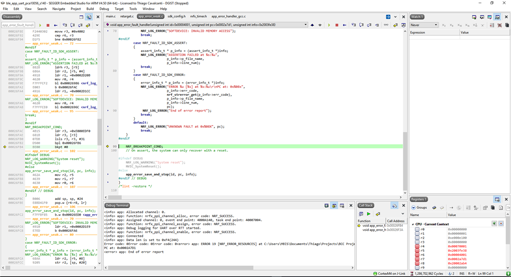

Debugging, I see that the SAADC is reading data well, however, I couldn't get any data at the smartphone.
I am getting the error shown on the image:
Could anyone help me to find a way to solve this problem?

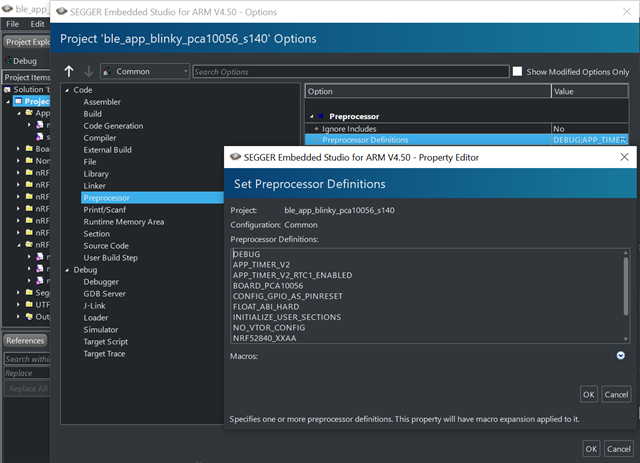

    Could you make sure that DEBUG is defined in your preprocessor definition, like shown in the included image?
    Enabling DEBUG will let you see which and where the error is generated.
    Please do this, and run the program again, to see the output and returning function written to the log.
    With this information, we can begin debugging and resolving the issue.

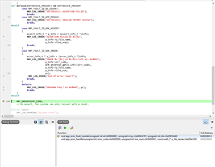

  • Thank you for your response.
    I followed your instruction and got the following messages:

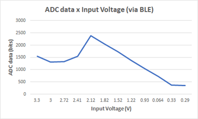

    I tested the ADC behavior using a voltage divider with a few resistors such as the image below:
    3.3V and ground are connected to the Vcc and GND from the dev. board. I measured all the voltage values with a multimeter.
    I read the ADC data using the debugging mode and after BLE transmission, using the nrf_connect app. The ADC values are shown in the following table:
    You can see the result graphically here:
    Not shown in the graph, but as can be seen in the table, when Vin is 0V, the ADC outputs 0xFFF.

    1. Reading the ADC data with the j-link connected to the board
    2. Using the USB from the computer to power the system. When we switched to a more stable power source this problem was fixed.
    Now that I think about that, I didn't try changing the input voltage after I used a stable power source. I will try it again and come back here to tell if it worked.
    Since we are now diverging from the original ticket's issue, I would ask you to open a new ticket for the SAADC investigation - to keep the forum tidy and easy to navigate for other users.
    I will reply to your previous comment here, but I ask that you create a new ticket for any followups you might have on this new issue.
    By this, do you mean that you specifically sample when the radio is and is not active? When the radio is active, it will draw a lot of current, possibly skewing your samples ( especially if you are using VDD/4 as your SAADC reference).

    Finally, we found that the causes of this problem were actually two:
    I am not sure I understand you here - are you saying that the source of the behavior seen in the graph and table you posted was verified to be the stability of your power source?
    If so, I would say this is a reasonable finding.
    I do not understand what you mean by this part, please elaborate.
    It will be interesting to see if you still see this behavior with a stable power source, but as I said initially, let us continue this in a separate ticket - since it diverges from the original issue of sending SAADC data over BLE.
