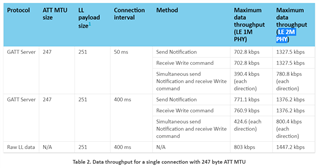

Hi! I'm currently using
- board: nRF52840 DK
- SoftDevice v15
- ble_app_template example + midi (adding custom service and characteristic)
I want to achieve maximum throughput, and so far this is what I found out
1. Use notifications
2. Raise the NRF_SDH_BLE_GATT_MAX_MTU_SIZE to 247
3. Raise the NRF_SDH_BLE_GAP_DATA_LENGTH to 251 ( I assumed this is enabling DLE)
4. Use LE 2M PHY
5. Minimize Connection interval
- #define MIN_CONN_INTERVAL MSEC_TO_UNITS(7.5, UNIT_1_25_MS
- #define MAX_CONN_INTERVAL MSEC_TO_UNITS(7.5, UNIT_1_25_MS)
1~3 worked fine. However, I have questions with 4 and 5.
Question1.
I read that the minimum connection interval should be 7.5. However, when I tried changing the value above to
#define MIN_CONN_INTERVAL MSEC_TO_UNITS(5, UNIT_0_625_MS)
#define MAX_CONN_INTERVAL MSEC_TO_UNITS(5, UNIT_0_625_MS)
I found out that this results in more better results. ( I could send more notifications in 1 second )
Why is this possible? And again, is the code written in 5 the minimum spec we can go to??
Question2.
The codes related to setting PHY are like below. With this code, when I connect to nRF Connect with my mobile phone(Galaxy S9) and read the PHY it is always set to 1MBPS. I've searched all day to change it to 2 MBPS, but just can't seem to change it.
