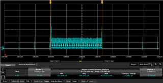

nrf52833 power consumption and time of the LFRC calibration
In another ticket I've found the following about the Nrf52832.
The calibration takes about 17ms and consumes 460µA in average during this time period.
What is the time the LFRC calibration takes and the current consumption of this action for the nrf52833 ?
