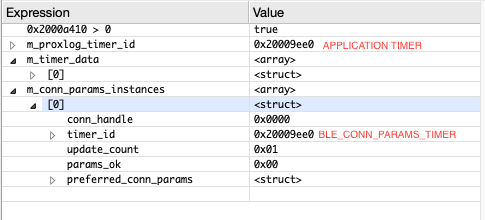

GAP Disconnect seems to stop first application timer
Using SDK 15.3 and S132.
I'm having similar behavior to the thread below:
https://devzone.nordicsemi.com/f/nordic-q-a/12066/gap-disconnect-stops-app-timer
After disconnecting with my nrf52 devkit, the conn_parameters module seems to stop my timer. If I disconnect from my nrf52 too fast (within 1 second of connecting), I get an error caused by 'update_timeout_handler' in ble_conn_params.c because it's trying to call 'send_update_request' after the disconnect has occurred. Unlike the OP in the other thread, I do in fact call conn_params_init(); at the start. Below my main() and conn_params_init(). I'm creating all my application timers by using APP_TIMER_DEF(). By debugging the code, I can see that the 'on_disconnect' function in ble_conn_params.c is stopping my application timer by calling 'app_timer_stop(p_instance->timer_id)'. Why does my application timer and the conn_params_timer have the same ID?
