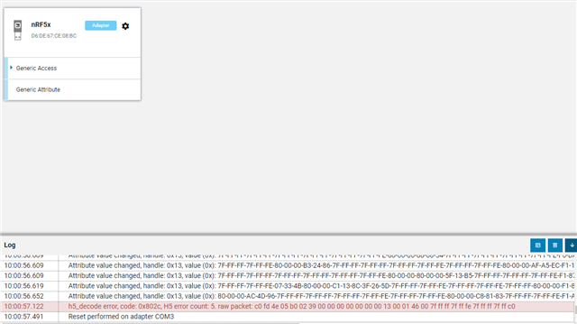

H5_decode error in nRF Connect
I had a problem while testing using the app_app_uart.
I added custom service and set tx buffer size to 70.
I tested  using nRF Connect.
And, i got error message like below.
If i set buffer size to 75, the error is not occurred.
I want to minimize buffer size.
Is not possible small buffer size in ble_app_uart?

  • mcu : nRF52832
  • sdk : 17.0.0
  • softdevice : 7.0.1

    This is the log.
    2020-09-24T00:39:25.738Z DEBUG GATTC_EVT_HVX time:2020-09-24T00:39:25.737Z connHandle:0 gattStatus:0 gattStatusName:success errorHandle:0 handle:19 type:1 len:36
    2020-09-24T00:39:25.738Z INFO Attribute value changed, handle: 0x13, value (0x): 77-37-22-7F-FF-FE-7F-FF-FF-7F-FF-FE-7F-FF-FF-7F-FF-FF-DB-9F-F0-80-00-00-03-49-93-7F-FF-FE-7F-FF-FF-7F-FF-FE

    2020-09-24T00:39:26.371Z DEBUG 66070/ 0 <-  [N/A] type:     VENDOR_SPECIFIC reliable:yes seq#:2 ack#:6 payload_length:f570 data_integrity:78 header_checksum:b6 err_code:0x802c
    2020-09-24T00:39:26.371Z ERROR h5_decode error, code: 0x802c, H5 error count: 1. raw packet: c0 f2 2e 03 dd 02 39 00 00 00 00 00 00 00 13 00 01 24 00 7f ff ff bd c6 f0 80 00 00 ba d8 c0
    2020-09-24T00:39:26.771Z DEBUG 66071/ 1 <-  [01 7e ] type: LINK_CONTROL_PACKET reliable: no seq#:0 ack#:0 payload_length:2 data_integrity:0 err_code:0x0 [SYNC]
    2020-09-24T00:39:26.771Z DEBUG State change: STATE_ACTIVE -> STATE_RESET
    2020-09-24T00:39:26.771Z DEBUG    66073 ->  [N/A] type:          RESERVED_5 reliable: no seq#:0 ack#:0 payload_length:0 data_integrity:0 err_code:0x0
    2020-09-24T00:39:26.775Z INFO Reset performed on adapter COM3
    This log is frmo the nRF Connect for Desktop app, not the nRF log. To see the nRF log you need to check that the nRF log module is enabled on sdk_config.c and if using UART backend see the output on a UART terminal or use RTT backend with RTT terminal. You can also see the nRF log output in a window in SES when you run your code on debug mode.
