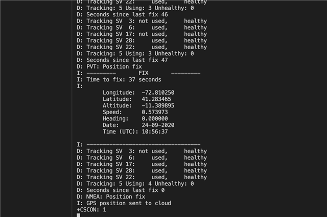

It appears that when publishing AGPS data to  nRF Cloud, the map does not appear as it did back in July. Is there any extra end-device configuration that needs to be done to make that happen? I'm currently using a nearly stock version of the nrf_cloud_agps sample.

    Do you mean that the map do no appear at all? (just a blank screen)
    If the device do not send the GPS position to nRF Cloud then the map does not appear at all.
    e.g. A successful GPS FIX.
    I: ---------       FIX       ---------
    I: Time to fix: 20 seconds
    I: Longitude:  5.399481
    Latitude:   61.362466
    Altitude:   10.276114
    Speed:      0.118597
    Heading:    0.000000
    Date:       09-07-2020
    Time (UTC): 08:52:29
    I: -----------------------------------
    D: Tracking SV 29:     used,     healthy
    D: Tracking SV  5:     used,     healthy
    D: Tracking SV  9:     used,     healthy
    D: Tracking SV 21: not used,     healthy
    D: Tracking SV 26:     used,     healthy
    D: Tracking: 5 Using: 4 Unhealthy: 0
    D: Seconds since last fix 0
    D: NMEA: Position fix
    I: GPS position sent to cloud

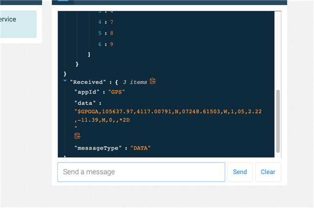

    It seems to be acquiring a fix. The cloud also appears to be receiving the data as well.

  • Hi Jared,
    Thank you very much for the additional information.
    The limitation looks to be on the cloud front end unfortunately.
    The reason is that it is missing a "deviceinfo" object in the shadow in the nrf cloud UI-code.
    The workaround is that you run the asset_tracker from a later stage (e.g. the master branch) first so it can send the "deviceInfo"-object to the shadow.
    So after you have connected with the asset_tracker application and then try out your sample you should be able to see the map info.
    I will report this internally to see if we can figure out how we can solve this on the cloud side.
