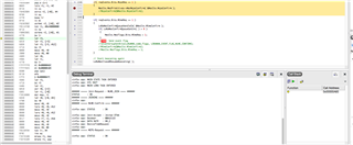

    I managed to solve the issue as it was more related to freertos. Now I have another issue that only occurs when I switch from bare metal to Freertos based on the same example. It's difficult to describe the error but It triggers when I try to execute a callback function on LoRaMac functions. I get the following error:
    The processor has made an unaligned memory access.
    I am developing the software upon the same example I stated before.
    Hamza
     This occurs in the nRF application, correct? Is it when trying to communicate with the LoRa module over SPI you see this error? Are you able to upload a debug log so we can get a better picture of the entirety of this application maybe?
