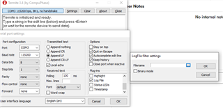

    The reason I ask these questions is that the nRF52832 doesn't have a USB peripheral. The USB port on the DK is connected to the programmer. I suspect that you are not developing a commercial product, if you intend to use the nRF52832 DK directly. However, in that case, you can use a UART terminal, such as Termite. This has an option to log the incoming data. You can do this through the Termite settings:
    This is probably possible using other UART terminals as well.
