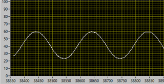

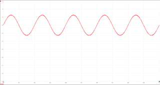

My problem is, that it looks like, that the readings of the SAADC are frequency-dependent.
I applied the following 5Hz sinus-signal to the analog input:
I receive the following readings from my SAADC:
This looks fine.

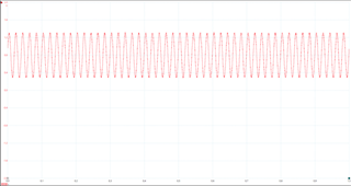

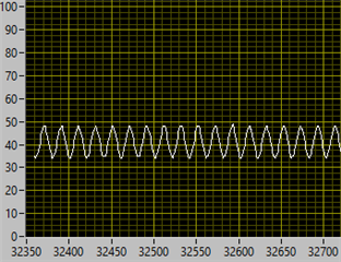

But if I apply a 50Hz sinus-signal with the same amplitude and offset to the analog input, which is shown in the following picture:
I receive the following saadc readings:
The amplitude of the SAADC readings is significantly lower.

  • Can you share raw samples of the two signals? We need to know whether the signals are sampled correctly or not.
    What is your buffer size?
    Are you running the SoftDevice as well?
    thank you very much for your quick response.
    50Hz signal (1 periode): [20 values] 42,39,38,36,35,34,34,35,37,39,41,43,45,47,48,48,48,47,46,43
    5Hz signal (1 periode): [200 values]  from 23 to 60
    -> the raw samples, which the SAADC outputs, are equal to the pictures.
    I set SAADC_SAMPLES_IN_BUFFER to 4. But I do not use this buffer, instead I created my own array for collecting the SAADC readings for further processing. Every time the SAADC callback function gets called, the SAADC reading gets written into this array:

  • The SoftDevice is most likely blocking/delaying your buffer handling, but you probably also have an issue with your signal source.
    I suggest you start by increasing the buffer size to a proper size, there's no point in creating multiple arrays from a single buffer if they're going to contain the same samples as if you just used one big one.
    I also suggest you try out the SAADC v2 driver in nRF5 SDK17, as it has a better buffer handling than the standard one.
    The SAADC is accurate up to 200ksps, 1ksps is not a problem.
    thank you for your reply.
    With your advice to take a look to the SAMPLES_IN_BUFFER I was able to figure out the problem.
    SAMPLES_IN_BUFFER was set to 4, which is okey if I use four channels.
    I set SAMPLES_IN_BUFFER to 1 (At the moment I am using only one channel). I receive correct readings from the saadc now.
    Unfortunaly, I can´t find anything within this link.
    Finally, thank you very much for your support.
  • If you set SAMPLES_IN_BUFFER to 1 then you will have sampling errors when the SoftDevice is running. A SAMPLES_IN_BUFFER of 4 is still critically low. At high buffer sizes the likelihood of sampling error will be reduced, but not eliminated. The v2 driver further reduces this likelihood.
