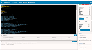

I then loaded the LTE monitor app.
2020-09-24T20:51:56.450Z INFO Application data folder: C:\Users\hadella\AppData\Roaming\nrfconnect\pc-nrfconnect-linkmonitor
2020-09-24T20:51:56.512Z DEBUG App pc-nrfconnect-linkmonitor v1.1.6 official
2020-09-24T20:51:56.512Z DEBUG App path: C:\Users\hadella\.nrfconnect-apps\node_modules\pc-nrfconnect-linkmonitor
2020-09-24T20:51:56.512Z DEBUG nRFConnect 3.5.0 is supported by the app (^3.2.0)
2020-09-24T20:51:56.512Z DEBUG nRFConnect path: C:\Users\hadella\AppData\Local\Programs\nrfconnect\resources\app.asar
2020-09-24T20:51:56.512Z DEBUG HomeDir: C:\Users\hadella
2020-09-24T20:51:56.512Z DEBUG TmpDir: C:\Users\hadella\AppData\Local\Temp
2020-09-24T20:52:04.953Z INFO Modem port is opened
2020-09-24T20:52:04.964Z DEBUG modem >> AT+CFUN?
2020-09-24T20:52:05.040Z DEBUG modem << +CFUN: 0
2020-09-24T20:52:05.043Z DEBUG modem << OK
2020-09-24T20:52:19.490Z DEBUG modem >> AT%XSYSTEMMODE?
2020-09-24T20:52:19.505Z DEBUG modem << %XSYSTEMMODE: 1,0,1,0
2020-09-24T20:52:19.510Z DEBUG modem << OK
2020-09-24T20:52:27.251Z DEBUG modem >> AT+CFUN=1
2020-09-24T20:52:27.299Z DEBUG modem << OK
2020-09-24T20:52:30.981Z DEBUG modem >> AT+CFUN?
2020-09-24T20:52:30.988Z DEBUG modem << +CFUN: 1
2020-09-24T20:52:31.008Z DEBUG modem << OK
2020-09-24T20:52:31.014Z DEBUG modem >> AT+CGSN=1
2020-09-24T20:52:31.097Z DEBUG modem << +CGSN: "352656100375743"
2020-09-24T20:52:31.100Z DEBUG modem << OK
2020-09-24T20:52:31.104Z DEBUG modem >> AT+CGMI
2020-09-24T20:52:31.198Z DEBUG modem << Nordic Semiconductor ASA
2020-09-24T20:52:31.201Z DEBUG modem << OK
2020-09-24T20:52:31.205Z DEBUG modem >> AT+CGMM
2020-09-24T20:52:31.302Z DEBUG modem << nRF9160-SICA
2020-09-24T20:52:31.304Z DEBUG modem << OK
2020-09-24T20:52:31.308Z DEBUG modem >> AT+CGMR
2020-09-24T20:52:31.405Z DEBUG modem << mfw_nrf9160_1.2.1
2020-09-24T20:52:31.416Z DEBUG modem << OK
2020-09-24T20:52:31.419Z INFO Nordic Semiconductor ASA nRF9160-SICA [mfw_nrf9160_1.2.1] SerNr: 352656100375743
2020-09-24T20:52:31.420Z DEBUG modem >> AT+CEMODE?
2020-09-24T20:52:31.512Z DEBUG modem << +CEMODE: 2
2020-09-24T20:52:31.515Z DEBUG modem << OK
2020-09-24T20:52:31.533Z DEBUG modem >> AT%XCBAND=?
2020-09-24T20:52:31.617Z DEBUG modem << %XCBAND: (1,2,3,4,5,8,12,13,18,19,20,25,26,28,66)
2020-09-24T20:52:31.620Z DEBUG modem << OK
2020-09-24T20:52:31.636Z DEBUG modem >> AT+CMEE?
2020-09-24T20:52:31.720Z DEBUG modem << +CMEE: 0
2020-09-24T20:52:31.722Z DEBUG modem << OK
2020-09-24T20:52:31.729Z DEBUG modem >> AT+CMEE=1
2020-09-24T20:52:31.821Z DEBUG modem << OK

I am trying to get GPS working. I have read through the link: https://devzone.nordicsemi.com/f/nordic-q-a/55578/nrf-9160-serial-lte-modem#permalink=542581
Whenever I try to run one of the GPS commands subsequent commands do not seem to work. For example, one I enter something like:
AT#XGPSRUN?
then any command entered later on has no response. The response given for the gps command doesn't match the other post. I'm not sure how to proceed.
