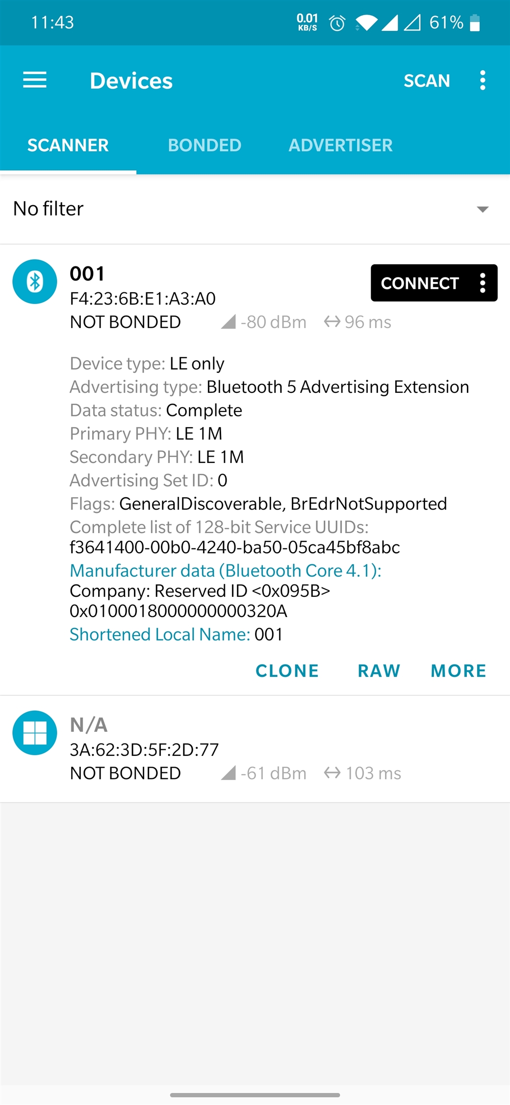

Scanning nRF BLE5 devices with advertisement extensions

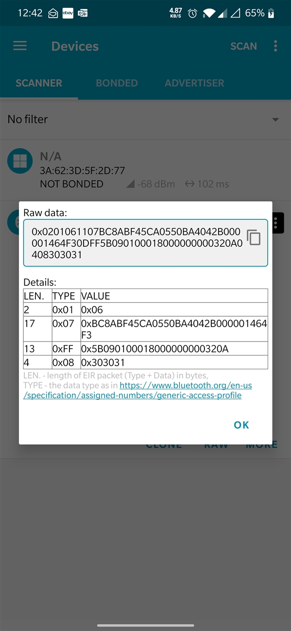

Can anyone confirm the advert sent in the attached is not corrupted in anyway? as I seem unable to scan my device with anything other then nRFConnect.
The Bluetooth advertising extension is enabled, all the android studio source offerings from Nordic fail to find them, is there a scanner available other then nRFConnect that I could use?
