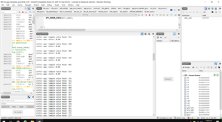

I am trying to integrate ADC in my project(ble_app_template) but getting garbage data. I have nothing connected with pin P0.4(NRF_SAADC_INPUT_AIN1). (Means not applied any voltage)
The behavior is the same with/without connecting NRF_SAADC_INPUT_AIN1 with input signal.
Here is my implementation.

  • Hi Muqarrab,
    A floating pin will normally generate random values.
    Here is an saadc example that I was working on lately. You can have a look, and see how you can achieve the analog reading also for the voltage conversion.
    Hope that helps.

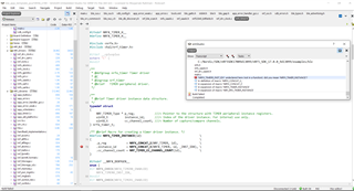

  • Just call nrfx_saadc_sample instead of triggering the sample task via the timer.
  • Hi ,
    I have made function and commented timer functions.
    But now the code is not working. Can you please refer to any example or guide how can I implement this   nrfx_saadc_sample?
    Really Thanks!
  • Try this:
