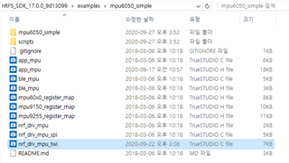

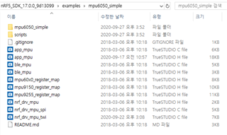

I am modifying the example of mpu6050 of sdk v14 in sdk v17.
After build, it is printed that there is no path to the file as shown in the image below.
(The captured picture doesn't look right.)

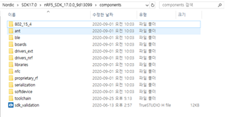

"Y:Nordic\SDK17.0\nRF5_SDK_17.0.0_9d13099\components\mpu_example\nrf_drv_mpu_twi.c: No such file or directory"
However, the path shown in the error does not contain the file and it is in the other path.
The same error occurs when you delete and add the file again.   Why is there such a problem?

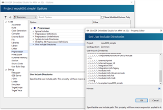

    I would just like to point out that the respository's main README states:
    • All examples are made for SDK 14.2.0. Other SDKs will not work. Download the zip file and extract to "sdk_14.2.0_folder\examples". Or just clone it to the same folder.
    In the first bulletpoint of the "How to use" description.
    You could of course try to modify or change it, to make it work with newer SDK versions, but I suppose there is a reason for why the author is being explicit here.
    Things could have changed in the drivers that the mpu project includes from the SDK, for example.
