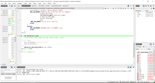

1-I am trying to upload Bottonless DFU and getting the following Error.
C:\Nordic\SDK\nRF5SDK17009d13099\nRF5_SDK_17.0.0_9d13099\examples\ble_peripheral\ble_app_buttonless_dfu\pca10056\s140\ses
2-How can I add butonless secure DFU service in my application?
As you can see from the debug log, the error occurs because there is no bootloader present in flash. This is the same error you reported earlier. You can ignore this error for now by commenting the error check for your ble_dfu_buttonless_async_svci_init() calll in main().
