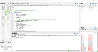

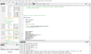

I am trying to upload nRF5_SDK_17.0.0_9d13099\examples\ble_peripheral\ble_app_buttonless_dfu but getting the follwing error. Can you please check?
Thanks
any suggestion please?

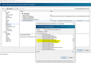

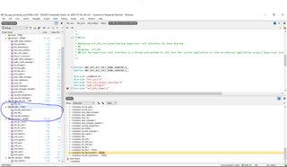

Yes, please make sure you have included the same include paths in your project as in the buttonless project.
I have fixed the above issue by adding a directory in the header files.

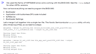

Now I have followed these steps to create a merge hex file.

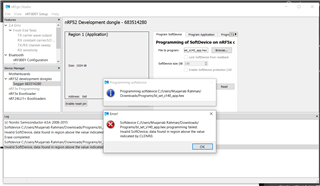

I am trying to upload the merge.hex file and getting the following issue.

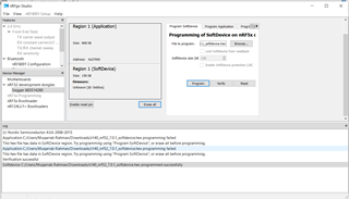

I have uploaded file form cmd but BLE is not advertising and not showing any response.

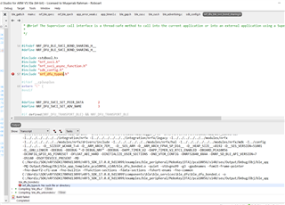

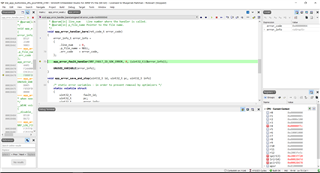

For my application, I am getting this error.
This error is reported because your central is trying to update an existing bond on your device, please see this post for a work-around: https://devzone.nordicsemi.com/f/nordic-q-a/51274/bonding-doesn-t-work-after-deleting-bond-info-on-nrf-connect
Muqarrab said:I am trying to upload the merge.hex file and getting the following issue.
Please use the Programmer app in nRF connect for desktop instead. It replaces nRFGO studio.
