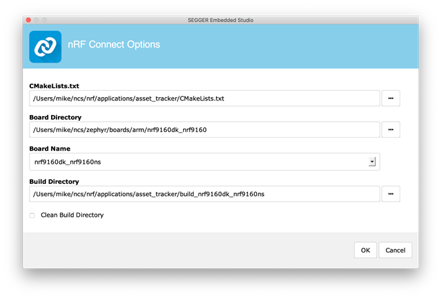

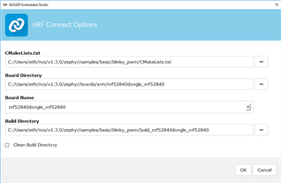

    • In the next step, Select File > Open nRF Connect SDK Project, these settings were tried repeatedly for multiple boards and the asset tracker sample app, but...

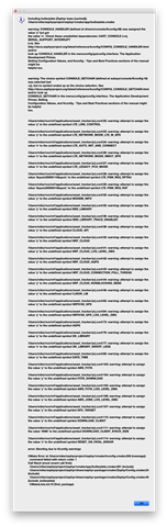

    • ...in all cases, when the "Click OK to open the project" was done and the configure and build scripts were run, they would fail in multiple and curious ways

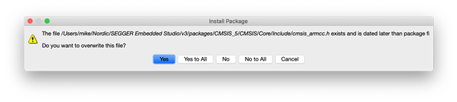

    • SES was already installed. No installation necessary.  But note: I get this warning each time I start it up.  Take the "No to all" branch

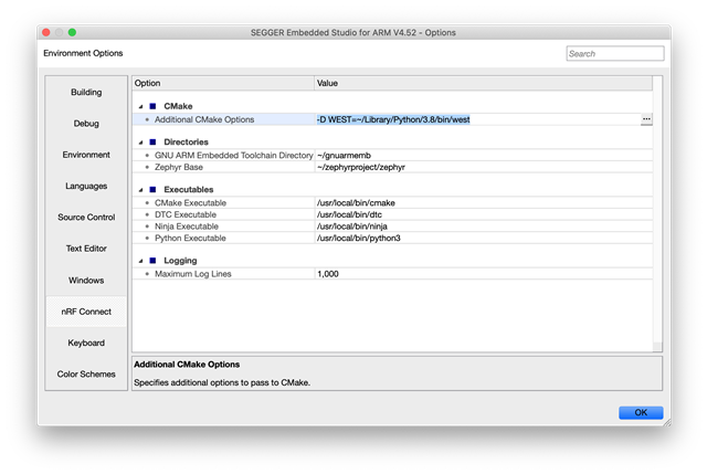

    • Went through the Environment Variable setting tab for Tools | Options | nRF Connect and verified all directory paths.

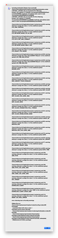

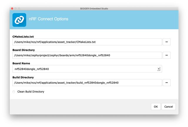

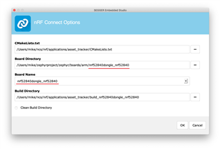

    • Invoked the menu command, File | Open nRF Connect Project and set the fields as follows:
    • Clicked the OK button, and got the following error dialog:
    So it looks like the problem is on the NCS side and not the Zephyr side.  Next step?
    Mike
  • Hi Mike,
    You cannot build the nRF91 Asset Tracker project for the nrf52840 dongle, which you do here:
    So that this fails is expected. If you want to build the asset tracker, then you must select the nRF91 (non-secure) board, as I showed in my previous post.
    If you want to build a sample for the nRF52840 dongle, then you must build a sample that works for that. For instance, to build PWM Blinky sample for the nRF52840 dongle you do this:

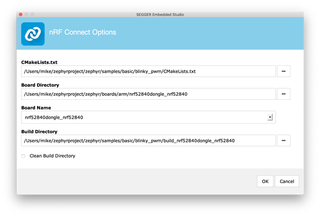

    Having said all of that, I'm not sure we've found the root of my problem yet.  Here's what I tried:
    1. I built a sample, Blinky_pwm (from the zephyr code repo) with the Nordic nRF52840 Dongle.  Here are the nRF Connect Options I used:
      The make process (i.e., "opening the nRF Connect project) worked fine and build proceeded fine.  The final linking failed because the module "elftools" was missing (but I presume that can be readily corrected.-- how?)

    So you figure out what's wrong with the GUI approach in SES???  One hint, it appears that "west" works differently when my current working directory changes.  In response to "west build -b nrf9160dk_nrf9160ns", I've gotten three different responses:
