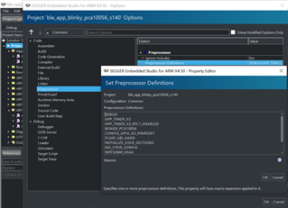

    Could you make sure that DEBUG is defined in your preprocessor defines, like shown in the included image?
    This will make the error be logged in a readable form, along with which function generated the error.
    Please do this, and let me know which function is generating the error, so we may take a look at what might be causing this.

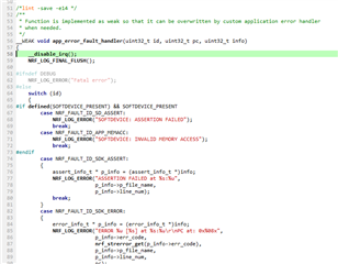

    In respect to debugging I am not quite sure if I did correctly what you asked for. I've defined DEBUG in the project options. Then I tried to follow this tutorial video in order to learn how I can make use of the debugging tools in SES and how to use the call stack for tracking where the error comes from. However, there where some issues with this. First thing was that my app_error.h file looks different than in the video. In the video (around 1:25) the app_error_handler is different than mine (I only have app_error_handler_bare which has fewer handover variables). I also cannot set any breakpoints there, they are always marked with a question mark. But my code does not seem to use the app_error.c functions anyway. Instead, it uses app_error_fault_handler from the file app_error_weak.c. When I set a breakpoint in this file as shown in the picture, I get the shown call stack.
    This depends on how you have implemented the application error handler. The default error handler is just to reset the device when an error is passed to it.
    Please enable the RTT backend, and try to see if this does not output a more detailed description of the encountered error to your SES debug terminal ( or RTT Viewer ).
