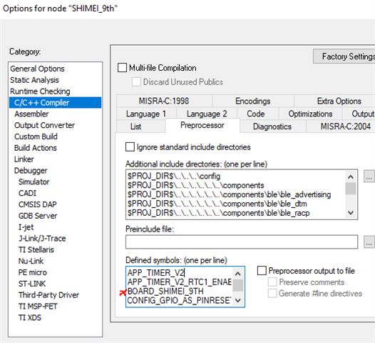

Hi.
I am developing on a custom board using nRF82820 / SDK 17.0.2.
A project was created by modifying examples \ble_peripheral\ble_app_gls.
There is no project for nRF52820 in ble_app_gls, so I modified some parts.
There was no error when compiling, but the following error occurred after downloading to the board.
IAR : 8.50.6
Attach the created project together. Can you tell what's wrong??

    I see that you have defined your own board file:
    And your list over preprocessor defines looks like this now:
    APP_TIMER_V2
    APP_TIMER_V2_RTC1_ENABLED
    BOARD_SHIMEI_9TH
    CONFIG_GPIO_AS_PINRESET
    DEBUG
    DEBUG_NRF
    DEVELOP_IN_NRF52833
    FLOAT_ABI_SOFT
    MBEDTLS_CONFIG_FILE=<nrf_crypto_mbedtls_config.h>
    NRF52
    NRF52820_XXAA
    NRFX_COREDEP_DELAY_US_LOOP_CYCLES=3
    NRF52_PAN_74
    NRF_APP_VERSION=0x00000001
    NRF_APP_VERSION_ADDR=0x1D000
    NRF_CRYPTO_MAX_INSTANCE_COUNT=1
    NRF_SD_BLE_API_VERSION=7
    S112
    SOFTDEVICE_PRESENT
    BOARD_PCA10100
    Are you using a nRF52820 on this SHIMEI_9TH board? If yes, then you need to remove these defines:
    DEVELOP_IN_NRF52833
    BOARD_PCA10100 (you should not use multiple board files)
    More information about this can be found at this page.
    Also make sure that S112 v7.2.0 is flashed to the chip.
    I corrected the part you told me, but I still have the same problem.
    I am changing it to "nRF52810 -> nRF52820", not "nRF52833 -> nRF52820".
    In this case, is there anything else that needs to be changed?
    I have tried using the example code with nothing modified, but the same symptom occurs.
    Also attach the modified sdk_config.h for nRF52820.

    APP_TIMER_V2
    DEBUG
    DEBUG_NRF
    FLOAT_ABI_SOFT
    NRF52
    NRF52820_XXAA
    NRF52_PAN_74
    S112
    SOFTDEVICE_PRESENT
    BOARD_PCA10100
