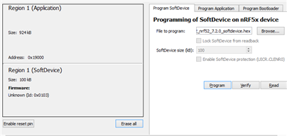

What is the --sd-req ?? -for this Soft device Version s112_nrf52_7.2.0
I use nRFGo Studio to determine the softdevice ID.
for your stack, s112_7.2.0, the ID is displayed as 0x0103
Suggestion for the nordic command: The stack ID can be added to the document "sxxx_nrf52_7.2.0_release-notes.pdf". It will be quite convenient.
Well, or tell me how to extract it from a hex file)
Thanks and Noted.
Now i can Done OTA Update
