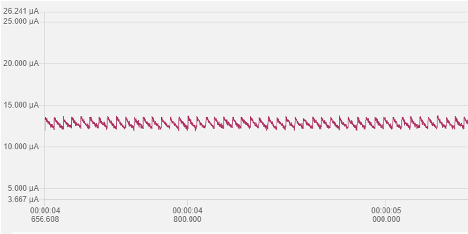

I am trying to make a simple power optimized BLE peripheral device based on nRF52840.
Here is the chart from the Power Profiler
The device advertises once in 2.5 seconds (big spikes on the chart ~7mA). Also I have a timer for my time counter, it fires up every second (smaller spikes ~40 micro Amps).  The device is in SystemOn state. I do call nrf_pwr_mgmt_run() in a loop inside main.
I am wondering what causes constant consumption ~12 micro Amps.
