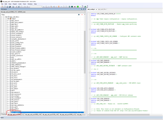

I encountered an issue when moving my project directory within my computer.
In fact, the linker seems to be unable to find some functions definitions :
Error[Li005]: no definition for "app_uart_init" [referenced from .....\main.o]
Error[Li005]: no definition for "app_uart_put" [referenced from .....\main.o]
These functions are defined in app_uart_fifo.c and the source file is included in my project workspace.
My investigations have shown that the first if condition of the source file is not working as expected:
#if NRF_MODULE_ENABLED(APP_UART)
app_uart_init definition
app_uart_put definition
Thus I checked if APP_UART_ENABLED was defined, and its defintion can be found in sdk_config.h which also is included within my project workspace.
Bypassing this if condition only creates more errors as some identifiers are undefined.
I don't know anymore what to try in order to fix my issue, any idea ?
(FYI I am working on IAR 8.50.6.28951)
Thanks in advance for your help !
