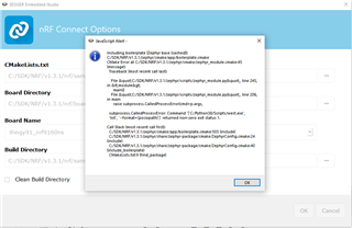

I've just moved over to the latest SDK version 1.3.1 (i uninstalled the previous version before installing the new one)
I installed it via the toolchain manager as usual.
SEGGER can no longer build Samples or Applications,
I just get this error when opening the project using the "Open nrf connect sdk project...."
I've managed to build the Asset tracker once but if I try to open the project using the "Clean Build Directory" option I also get this error.
Any ideas would be great.

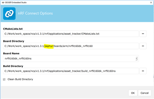

    First, You could check the project setting.

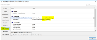

    Second, check the environment option (From Tools -> Option -> nRF Connect) is correct to your path.
    Please let me know this can help or not. Thanks.
    -Amanda H.
  • First - Yup board is correct, same error whether i build against the nrf9160DK or the thingy91 board in the nrf board folder
    Second - Checked and my values for the configuration are the same as the ones in your screenshot

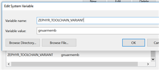

    It seems it cannot find the gnuarmemb. Please add ncs\v1.3.1\toolchain\opt to the environment variable as GNUARMEMB_TOOLCHAIN_PATH.
    -Amanda H.
